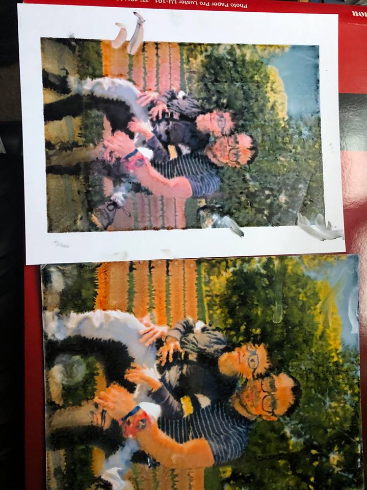

I just bought a pixma pro 100 and the prints are coming out HORRIBLE, please help me

This is roughly what I see when paper is inserted wrong-side up.
If you pull out a sheet of luster paper and old it an angle to some light, you'll notice one side is just flat (as if it were just plain copier paper) and the other side has a sheen to it. Glossy paper will have a glossy finish only on one side. Luster paper will have a sheet with a very fine grainy shine on one side. That side with the sheen or shine is the printing side.
Make sure the printing side is face up. When you load paper in the rear (top/back of the printer) that side is facing you.

11-24-2018 11:37 AM
ok you were right about that I inserted in the wrong side up, but now i'm using a different size (13x19) but same quality a pro luster and this time I put the paper correctly and now this happen, Why can I print really well on letter but when I try to do 13x19 that happen?
11-24-2018 12:08 PM
Was the 13x19 luster inserted right-side up? Did you select the correct paper type when printing?
I have four different printers and it seems like if I change one thing, all sorts of things revert back to defaults and I have to be careful to select each choice.
Mostly I've developed the habbit of picking (1) correct printer, (2) correct media size, (3) correct color profile, (4) correct paper type... and (5) check the quality level.
I have to make sure all of those are correct before sending the job to the printer (and media needs to be right-side up). Just occasionally I'm a little too rushed to check the paper and still get it wrong.
11-24-2018 12:16 PM
Was the 13x19 luster inserted right-side up? YES, the back side is brown so I definitely know that it is in the right side
Did you select the correct paper type when printing? YES, is the same type of paper than the letter size
I already check everthing and stil don't know why this is happening.
Than you for your help.
11-24-2018 01:25 PM
The back-side is brown? What brand is this paper?
I have a selection of papers from different paper manufacturers (Canon, Moab, and Red River ... but there are papers I haven't tried such as Ilford or Canson, etc.)
But ... most of the papers come wrapped in a pack where the top of the stack is protected by a single piece of card-stock (the top sheet isn't actually photographic paper) ... so when you said the back was brown it made me wonder if the protective card was inserted instead of photo luster paper.
11-24-2018 04:45 PM
You were right again, Im soo dumb! lol THANK YOU
11-24-2018 05:29 PM
If it makes you feel any better... I only know this stuff because I’ve made many of the same mistakes. 🙂
