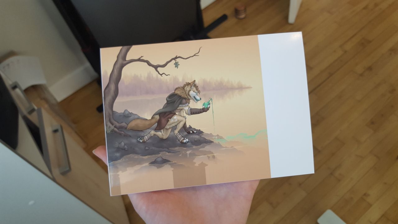

Above is the print result. The right side of the image is left unprinted on, and the bottom has weird color fill with the bottom colors of the image.
I've done two tests so far with similar results and I'm hoping not to waste more ink or sheets before I have this figured out or a closer idea.

I'm having the exact same issue so I'm quite keen to see this one asnwered. Right down to it bein 5x7
02-19-2019 11:12 PM
Haven't fixed it yet, but changing the layout mode to borderless makes the random color sides *smaller* but doesn't make them go away.
02-21-2019 05:51 PM
Fixed the issue: I was using print studio pro plugin, if your image has multiple layers it creates garbage data. So in my case, i imported a flat image on to its own layer, but I still had the default photoshop layer under it. So once I flatted everything into a single layer, it prints no problem!
