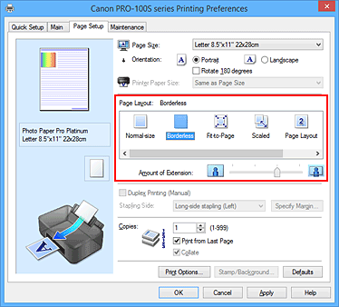

WinBorderless
Since the real margin of the paper is extending past the bleed area, try extending the "Amount of Extension" in the Borderless printing options, to try covering the remainder.
