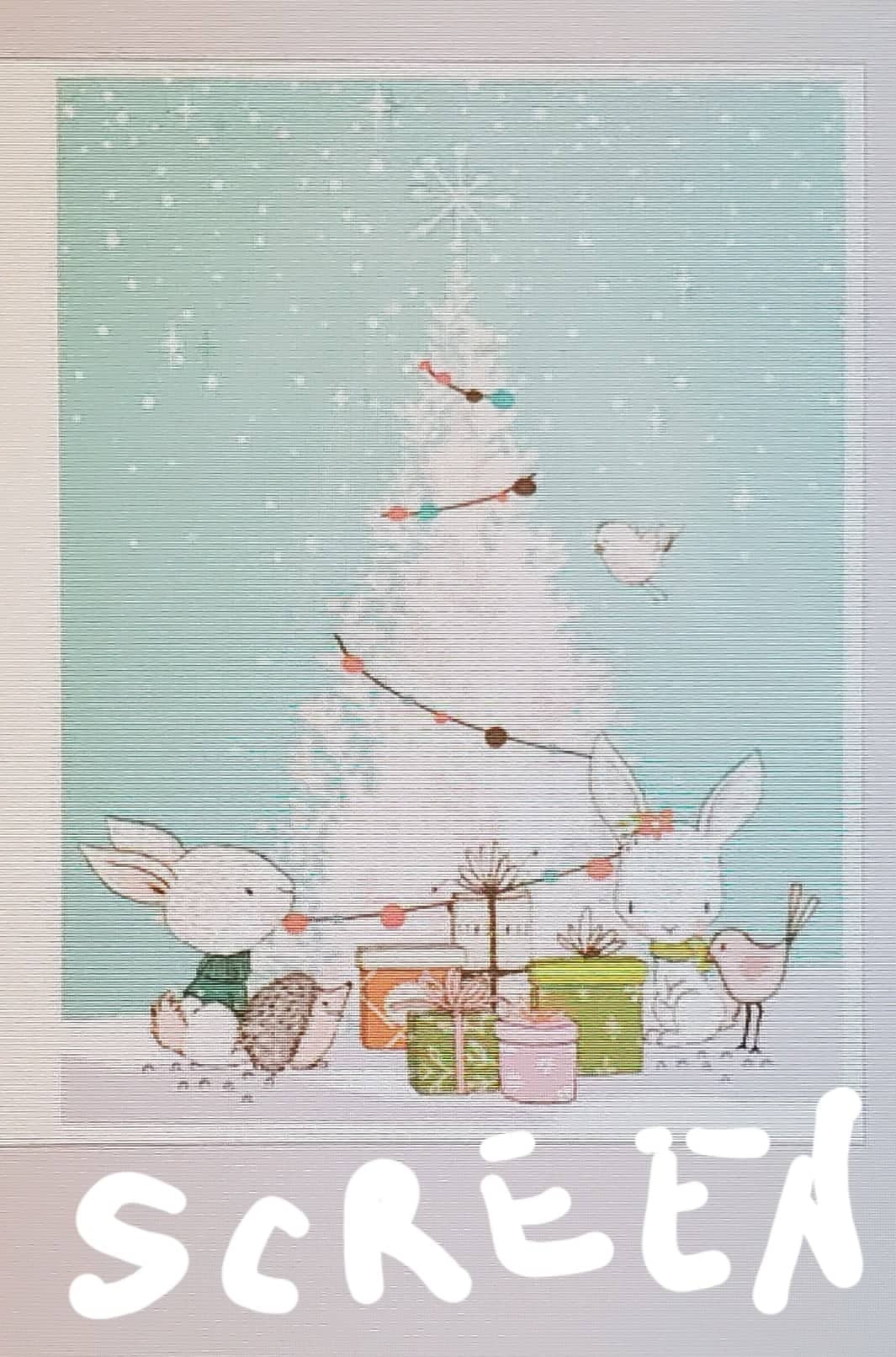

11-29-2021 12:42 PM
My screen and old printer were very close. What I saw on the screen printed. The new printer prints very dark. Even when I tell the color management to brighten the print. I don't want to adjust my screen, as I have hundreds of cards bult with specific color pallets that would take thousands of hours to change. I need to the new printer to print as the old one did (which just so happens to print close to my screen colors). I'm sending the same data to each printer. I don't do anything to the old printer, just hit print. But, clearly I need to adjust some setting to get this new printer to print correctly. The new printer prints the same way with Word documents (much darker than the older printer and much darker than what's on my screen.)
