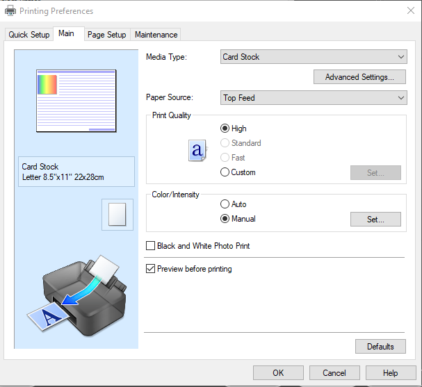

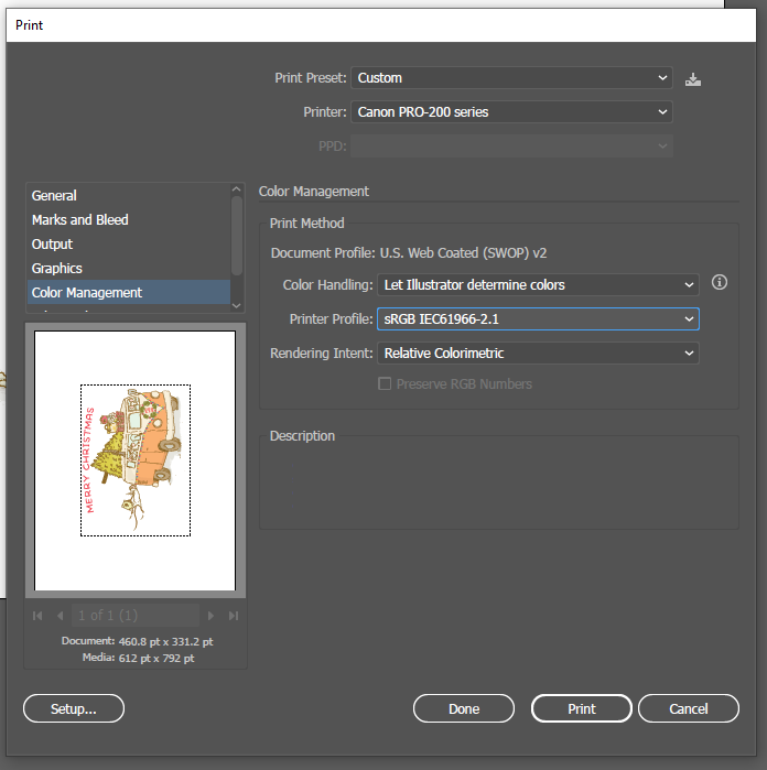

I design and print greeting cards.  Very simple items.  I previously had a Epson ET 2550 printer.  Pretty low end, but it printed fine.  However, it doesn't handle card stock very well, and became quite old!!  So, I purchased a new Cannon Pixma Pro-200 so that I could print both my greeting cards, as well as my sons photos.  It is printing too dark.  Darker than the Epson and darker than what I see on screen.  Previously the Epson and the screen matched pretty well.  Nearly the same.
Now I'm struggling to get the Canon to print the "right" colors.  I don't want to change my color pallets in Illustrator, as I have hundreds of cards designed with specific skin tones and they are now printing too dark.
I'm hoping you can help.
I thought I'd start with your first two suggestions:  tell the printer it doesn't control color and tell illustrator it does.
Could you share instructions for:
1.  Turning off every bit off control the printer has?
2.  Settings in Adobe Illustrator to handle all print settings and color matching.
Toby

Cannon Printer Main Settings -- Manual None.PNGIllustrator Printer driver screen.PNGCannon Printer Main Settings -- Manual None.PNG

A possible error is the printer profile that is selected.
I believe you should be selecting the ICC profile for the paper you are printing on.
You also need these settings if you haven't set them:

There are three main most things you need correct on your monitor. The contrast, brightness and the grayscale needs to be very close to spot on. You do need to be using the correct ICC profile too. Check out the last picture in John's reply above. It's important.
I can't help with Illustrator but the screen shot looks a lot like PS.

My screen and olScreen Shot.jpgold and new printer.jpgd printer were very close.  What I saw on the screen printed.  The new printer prints very dark.  Even when I tell the color management to brighten the print.  I don't want to adjust my screen, as I have hundreds of cards bult with specific color pallets that would take thousands of hours to change.  I need to the new printer to print as the old one did (which just so happens to print close to my screen colors).  I'm sending the same data to each printer.  I don't do anything to the old printer, just hit print.  But, clearly I need to adjust some setting to get this new printer to print correctly.  The new printer prints the same way with Word documents (much darker than the older printer and much darker than what's on my screen.)
I have set the color management to manual/none.
I've tried multiple ICC settings.  They all print too dark.  The sRGB... setting is the lightest I found.
