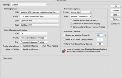

I’ve been researching for a couple of days now how to fix my dark images and tried the suggestions made in some of the threads in this forum and I’ve had no success. I’m printing greeting cards and working in Illustrator. My images print darker using Illustrator and Acrobat but print lighter in Photoshop. If my printer could print in between these two settings, it would be much closer to what I see on my screen!
The closest I’ve got is to open my Illustrator file in Photoshop, (sometimes play around with saturation, contrast, and brightness) remove the Black channel just for preview purposes and turn it back on before print. If I turn off the Black channel in Photoshop, I’ve found that it gives me a more accurate sample of what the final image will look like.
I have a Macbook Pro (2014) and have calibrated my screen with a Spyder4Elite. I’ve printed the Test print in this thread and my image looks ver similar to what it looked like for kmeyers. I have Illustrator and Photoshop control the colors in the print settings. I think I have disabled my printer from controlling anything (image below). I’ve tried printing with the various Canon paper printer profiles and the colors are still off. Should I be trying one in particular? For now I'm just using the latest Spyder callibration printer profile I've created. Using a design with reds and yellows, if I use the Matte paper option the yellows are good but the reds are still dark and with the Fine Art options the images are much darker. I’m using Neenah paper and since I can’t find ICC profiles for them online, I tried using Red Rivers ICC paper profiles that I think match my paper. I’m using 100g/m2 paper in a pretty bright white color (Neenah Environment Smooth Finish White to be exact).

Here are my color settings in Illustrator and Photoshop:
Illustrator-
Illustrator Color Settings 1:7:15.png
Photoshop-
Photoshop Color settins 1:7:15.png
I don’t want to be playing a guessing game every time I design a card (especially if the card needs layer adjustments in Photoshop). If my designs in Illustrator could be a little bit closer to what it could print, it would be much easier to visualize the final product. Is there a way I could reduce the Black channel (if such thing exists) automatically in Illustrator or in my computer settings so the final image is more accurate? Any help would be highly appreciated.
I think you have your color management choices selected incorrectly. The RGB profile you chose is the monitor profile; not to be used for printing.
See this article:http://www.photoshopessentials.com/basics/color-settings/

Thanks for the help!
jrhoffman75 the link was super helpful and it helped me better understand how to calibrate my screen. My prints are now printing much closer to what I see on the screen. Though not perfect, I'm much satisfied where I am now. I was trying to get the printer to do everything but had not done much with my screen settings as I thought I did. I also found this link to have useful info on how to set up my Proof preview so my screen is more accurate to my print: http://www.digitalartsonline.co.uk/features/illustration/top-10-tips-preparing-images-for-print/
ebiggs - after going through the link above and reading your message things made a lot of sense. I'm glad I'm not the only one who has to create/edit my work in one program and print in another.
