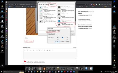

12-17-2024 02:32 PM
Try this setting in the driver:
12-17-2024 04:04 PM
Hi, you have set us on the right track. Our options are very limited with 11 year old model, but found one that says "bottom plate cleaning" for smudges. Have done the process 4 times and am still getting smudges. I'll continue...
Much appreciation!
Jed
