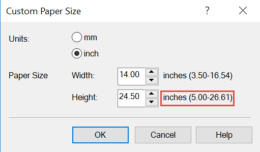

I must be going insane.  I've stared at that page in the PRO-10 manual for hours and for some reason I could have sworn the max size for the Manual Feed Tray was 14x26.61.  I just looked again and it is identical to what you posted: 14x23.  Like I said, I must be going insane.  It doesn't help that the custom paper size dialog box is not specific to the selected feed tray (picture below).
I'm a little new to printing, just got my printer in August.  But the fact that there is any maximum length seems a little odd to me.  Obviously the max width is limited by carriage, but it seems odd to me there is a maximum length.  And especially odd is the fact the max length is different for the two feed trays.

The ppd CanonIJPRO100series.ppd.gz lists 26.61 as maximum size (actually 1908 points). A warning about the size would be displayed whenever I tried printing. Only be editing the custom size to 23" was I able to print. Because I already cut a sheet to 26.5",  I know. that it can feed that people. But the reason "the ability of the printer to handle the paper." makes no sense. If the printer can't feed that paper, why put that in the manual and the. ppd?

Yes, I am trying to print from the Rear Tray. I slowly lowered the custom paper size; 26.5", 26", 25", 24" and it would only print when I reached 23"
What width? I just ran a test on my Pro-100. If I set the Custom Size to 13x26.61 I got a similar error message.
If I lowered the width to 12.95 I didn't get the error message.

davidwcanon
Thank you, that solved the problem
