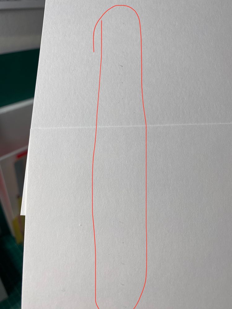

Hi everyone! I've been experiencing these black ink spots always on the left side of my prints for a few months now. I've called Canon support before and they told me it's something with my print settings, but the issue comes and goes with no change on my end of paper or print settings.
It started happening again after a few months of clean prints. When it happens I usually try to soak up excess ink in the discharge pads on the left side. Last time I took out the print head to try to see if there was any gunk on it (not super comfortable cleaning the whole thing, so I just use a q-tip to wipe around).
I'm printing on 110 lb matte cover stock paper. I've run nozzle checks and cleanings and I have no issues with the color print quality.
For clarity sake, this is what happens when I print on High Quality. The issue is most apparent when I print on this setting, but I normally print on Standard setting and the marks are not always consistent (multiple dots, light/dark).
Here's the appearance of the spots on Standard setting. I've circled the area:
Anyone have insight on what is likely causing this? Thanks so much for your help.

Thanks for responding! I've done bottom plate cleanings as well and unfortunately it hasn't stopped the dots from appearing.
Should bottom plate cleaning help with issues that appear on top of the paper as well? Just curious how it works for troubleshooting purposes. As sometimes when I run this cleaning I see black smudges on the top of the paper too.
