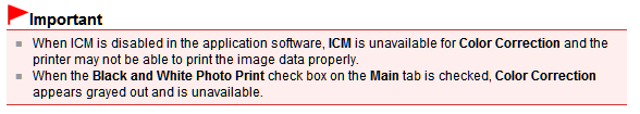

I think I found something here, all spelled out in the user guide.
Note here: "COLOR INKS MAY BE USED AS WELL"
Another important bit of information:
So even if you select a custom profile using specific type of paper, Canon disables custom color correction and chooses what to do if the "Black and White Print" check box is selected???
