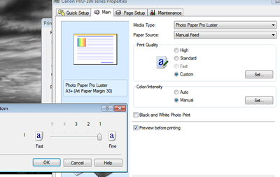

3. Quality in B&W printing. This is setting the image to Black and White Printing. Quality goes as high as 2
This is with the Black and White Photo Print not checked, Quality can go to 1.
These screens shots are from Canon's Plug-in Print Utility:
I am sure it really doesn't add much between 1 and 2, as stated in reviews I have read, but why not have a choice. Just an observation.

1. Printer dialog settings: Black and White Photo Print - Unchecked, Image Quality = 1 (highest)
2. Printer dialog settings: Black and White Photo Print - Checked, Image Quality = 2 (highest in black and white print mode)
I printed on the same sheet of paper, rotating the paper after it was finished so I could achieve a comparison using the same page. I cut the sheet into two and compared, by eye, the prints side-by-side.
The image that was printed using the "Black and White Photo Print" has a very slight greenish tint. The un-checked, highest quality print looks great. When I find a scanner I will scan and check the images to see if my "calibrated" eyes are telling me the truth or if age is messing with me.

I think I found something here, all spelled out in the user guide.
Note here: "COLOR INKS MAY BE USED AS WELL"
Another important bit of information:
So even if you select a custom profile using specific type of paper, Canon disables custom color correction and chooses what to do if the "Black and White Print" check box is selected???
