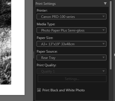

3. Quality in B&W printing. This is setting the image to Black and White Printing. Quality goes as high as 2
This is with the Black and White Photo Print not checked, Quality can go to 1.
These screens shots are from Canon's Plug-in Print Utility:
I am sure it really doesn't add much between 1 and 2, as stated in reviews I have read, but why not have a choice. Just an observation.

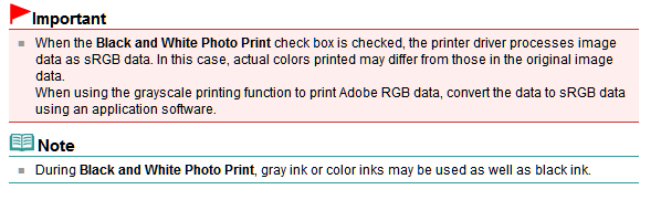

I think I found something here, all spelled out in the user guide.
Note here: "COLOR INKS MAY BE USED AS WELL"
Another important bit of information:
So even if you select a custom profile using specific type of paper, Canon disables custom color correction and chooses what to do if the "Black and White Print" check box is selected???
