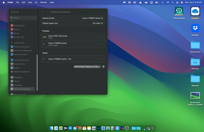

In my printer settings it shows "Kind" as Canon Pro-200 series-AirPrint" and Driver version 2.0. That setting is greyed out, preventing any changes in that dialog box. It's not clear to me where the change can be made.
01-06-2025 06:59 PM
That's your problem - you have the limited capability Apple driver, not the Canon driver that unlocks the capability of your printer.
Go back to Printers & Scanners and select Add Printer. When the dialog box appears wait until Canon IJ Series printer appears; it could take several minutes. When it appears select that printer. When it is installed delete the AirPrint printer.

I have given it about 15 minutes. This is all that has shown up.
I will check for any downloads that should have been installed with my printer. It's a few years old. I will get to that tomorrow morning and let you know what I find.
Thank you.
01-06-2025 07:25 PM
"Canon Pro-200 series"

I have the same problem, download tje Canon IJ driver, but see the same airprinter appears when adding the printer.
I think because that I have very limited possibilities of changing preferences when I want to print something (and I don't think it use the Ilford ICC profiles -> BW turns out very green 😞
