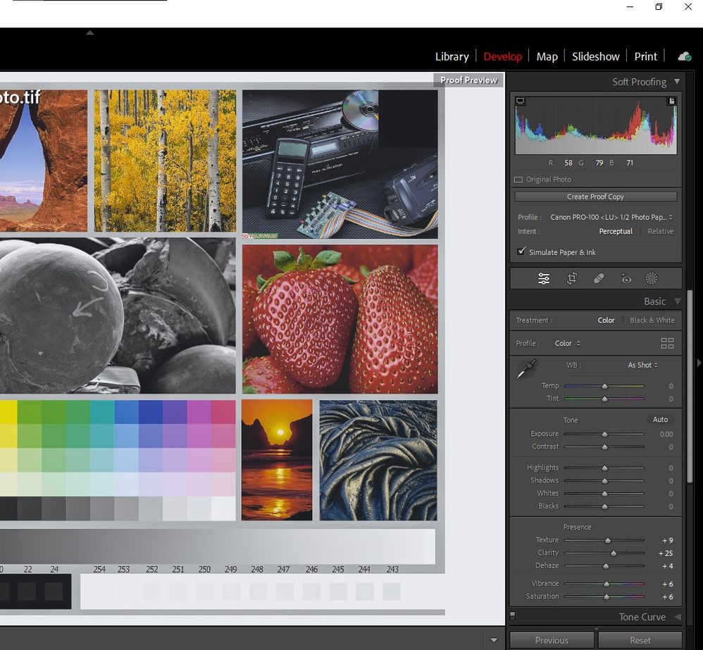

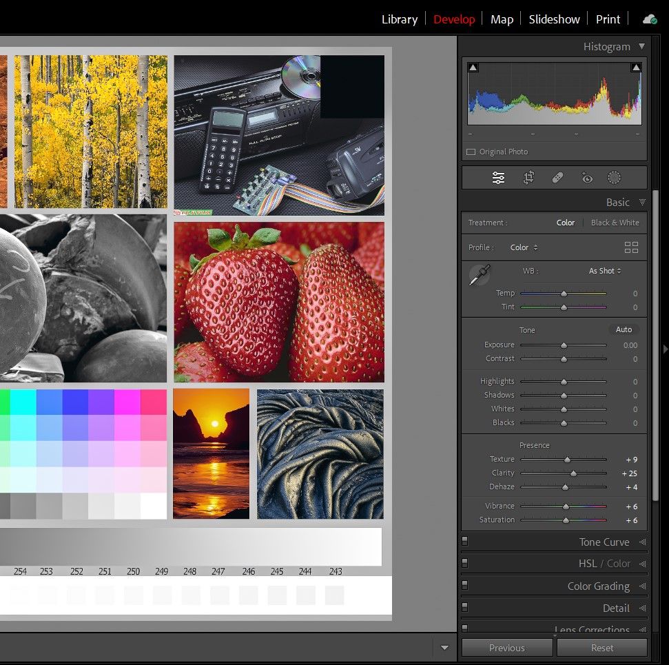

Lucky for me it's snowing in your neck of the woods....Print looks VERY good...if I had any nits to pick, the print is just a tad darker than the monitor in terms of "brightness"..but just a tad.  Do you suggest turning my monitor brightness down a bit in the soft proof mode in LRC?
Since monitor is transmitted light it will seem brighter. The only time it could cause a problem is if you reduce exposure because you think the image is too bright. Won't hurt to reduce brightness a bit so they match better.
Do the colors look OK in the test print?
The Develop module in LrC isn't color managed, so the softproofing could look a little different.
When I switch soft proofing on/off the colors are slightly more subdued.
Soft ProofSoft ProofDisplayDisplay
