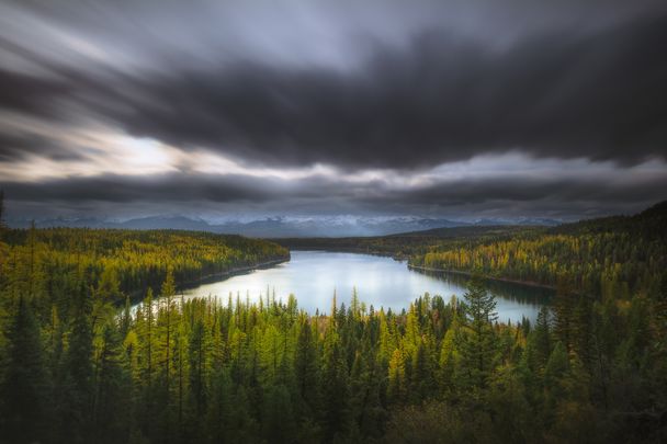

Original file... The original image..

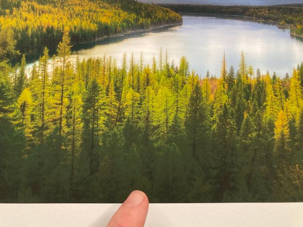

.Posterization in front, dark trees
The print (crappy iPhone photo, hence the colors are whacky) showing the posterization in the dark foreground trees.Posterization in the sky

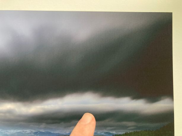

The print (again, crappy iPhone photo) showing the posterization in the sky.

Alright, the problem is solved! In case anybody else runs in this, this is what I did...
- THE PROBLEM: I was using the 'manage with printer' settings in the Lightroom printing module. In the print dialog box, I then selected the appropriate color profile and media type for the paper. This resulted in blotchy shadow details. No good!
- THE SOLUTION: I, instead, chose to manage the color in Lightroom, choosing the correct paper profile there and 'perceptual' as the rendering intent option. This resulted in a perfect print! No blotchy shadows.
