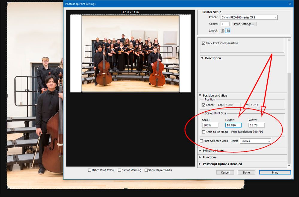

Me too! I always print directly from PS or LR. However, in PS there are two places where you need to check image size. If you ar printing an 11x14" I suspect you are using 11x17" paper?
First select borderless in the print menu. When you click print in PS check out this screen carefully.
Although the image size is 11x14" you see PS has reduced it. Simply change that to 11x14". Keep in mind the printer needs a bleed area. Not all sizes are available with certain paper sizes.
