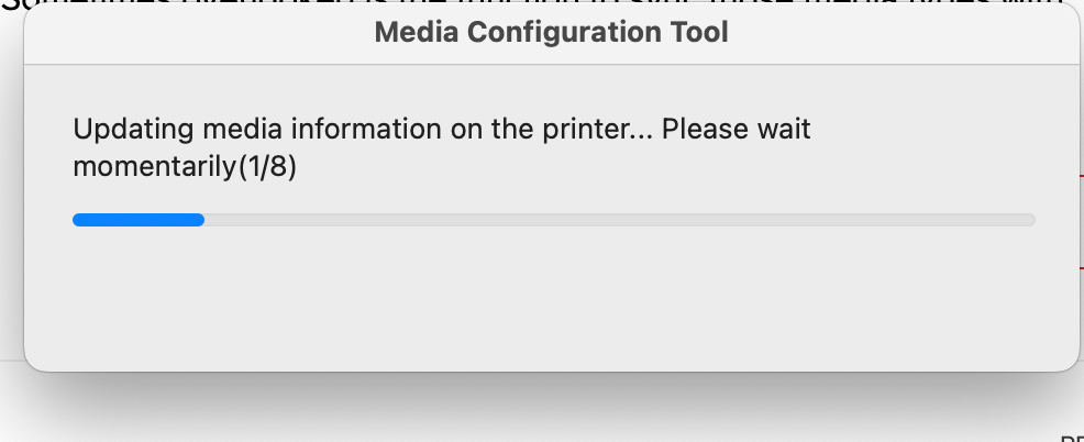

I recently purchased a Canon PRO-1100 photo printer and successfully installed all the drivers. The printer is functioning well overall, but I'm facing an issue with the paper types displayed.
The list of paper types shown on the printer's display does not match the list in the Media Configuration Tool on my computer. Specifically, there are around seven types of paper that are visible in the Media Configuration Tool but do not appear on the printer's display, even though the tool shows that these paper types are registered in the printer.
Could you please assist me in resolving this issue? Why are the paper types not appearing on the printer’s display, despite being shown as registered in the tool?

Have you downloaded and installed the other software from Canon's site? One of them is the Media Configuration tool that is used to create your media types. Sometimes overlooked is the function to sync those media types with the printer and driver.
10-22-2024 11:25 AM
Yes, I use this Media Configuration tool. Although the selected papers do not appear on the printer display, the tool's software, as shown in the screenshots, shows the papers are already saved in the printer. I included all the selected papers, but after the update, I still cannot see or utilize them on the printer.

OK, I actually solved my issue. The issue is that after using the Media Configuration Tool I immediately went over to the printer and tried to verify my new paper setting was available. The problem is that the top level menu item where you select paper size / type is for the Top Feed ONLY. So if the paper you add (invisibly) marks itself for manual feed only you will never see it in that menu setting. The easiest way to verify a new paper setting reliably is to close the top feed, open the manual feed and then place a piece of paper (any type) into the feed. It should then auto-detect the manual feed load and pull up the manual feed setting dialog on the printer for you and NOW you can see your special paper show up.
