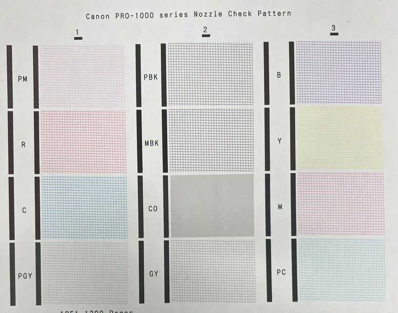

Hi mrkjhn,
First, let's print a test page. To do this, please follow these steps:
1. Make sure that the power is turned on to your imagePROGRAF PRO-1000.
2. Load a sheet of A4 or Letter-sized plain paper in the rear tray.
3. After inserting the paper into the machine, the paper information registration screen is displayed on the touch screen. Select A4 or Letter for Page size and Plain paper for Type, then tap Register. If a message is displayed on the screen, follow the directions in the message to complete registration.
4. Holding both sides of the paper output tray, gently open it.
5. Extend the paper output support..
6. Use the down arrow to select Maintenance and press OK.
7. Select Print nozzle check pattern and press OK.
8. Select Yes and press OK.
Once printed, please compare your test page with the example below. Does your test page print correctly?
