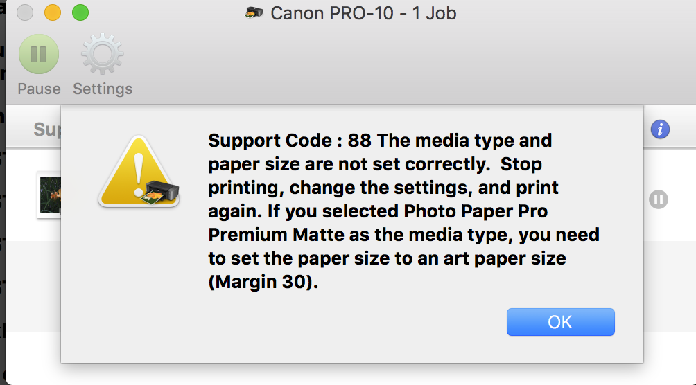

Unfortunately, when you attempt to print with any paper size setting other than an explicity Fine Art size you get this:
This only occurs after the print starts in the print queue, so its in the drivers rather than the appliations software.  I'm using Affinity Photo in this example, but I get the same behavior with Apple Photo as well.  This is consistent with the behavior described elsewhere.
