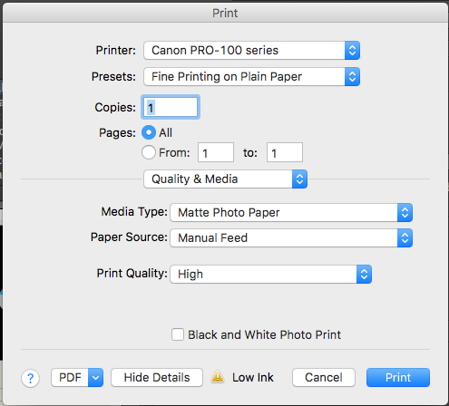

I'm having banding issues in the black ink. This doesn't happen using other colors. In the bottom of the poster shown below, the black has a band on the bottom.
I'm using 13x19" Epson Ultra Premium Matte Paper on a Macbook Pros Sierra 10.12.6 in Adobe Illustrator CS6. The printer settings are below. I've already cleaned the nozzles, bottom plate and roller and the same banding appears.
10-08-2017 12:46 PM
I don't know if this is your problem, but you have a setting mismatch.
You are calling for printing on plain paper but you selected matte photo paper as the media.
Try selecting Default Settings as the preset and Matte Photo Paper for the media type and see what happens.
10-08-2017 01:06 PM
Thank you John, I'll try that.
