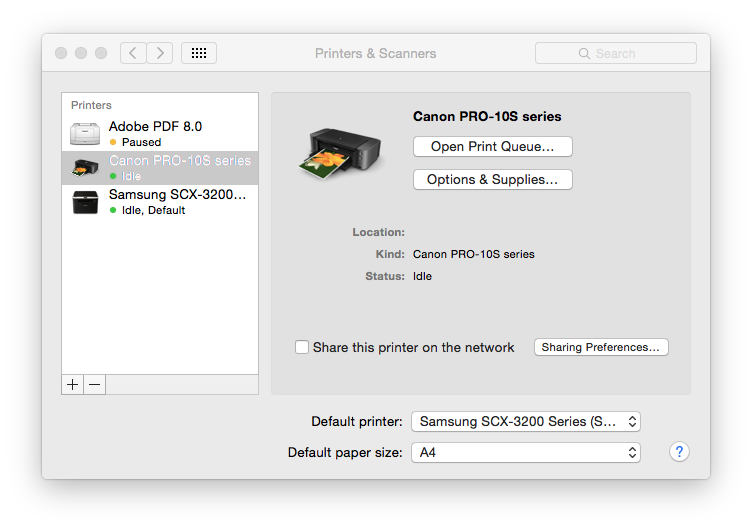

I guess i do - screen grab attached.
I'm, trying to print to A4 ( margin 30 fine art)
I can't test to A3+ yet as I don't have the stock was hoping to test colour reproduction before spending on the more expensive paper.
The only other thing I can think of - if you select Paper Setup in LR do you get the proper paper size in the driver popup?

Hey John,
Appriciate your time on this, very much so.
I do get the correct page set up information
Oddly enough, I've just reinstalled the drivers and whilst activiating the printer in settings this happened - there appear to be two drivers for the printer - one Bonjour as you mentioned, and one marked Canon IJ Network
But If i select the latter - it turns into Bonjour, only to reappear when i try and add another printer driver.
Could this be what is causing the issue ?
