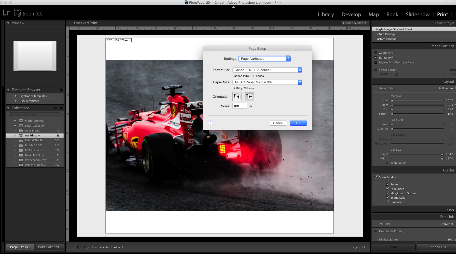

However, when I try and print to fine art papers the image will not centre - specifically on A4 (210x297mm)
I am aware of the margin 30 setting for thicker papers - but no matter how I set the job up - the print will come out off centre and at the wrong size (scanned example below)
For instance; lightroom preview gives me a printed area size of 150x237mm on a sheet of A4 which make sense - 30mm margins all around.
But when printed, prints come out smaller at a printed ara size of 210x140mm and with inconsistent margins.
The same happens in Canon's Print Shop Pro, but the alignment is inconsistent with Lightroom. Lightroom's PSP plugin also.
I have attached some screen grabs and scan so you can see the comparison of software against result.

I guess i do - screen grab attached.
I'm, trying to print to A4 ( margin 30 fine art)
I can't test to A3+ yet as I don't have the stock was hoping to test colour reproduction before spending on the more expensive paper.
The only other thing I can think of - if you select Paper Setup in LR do you get the proper paper size in the driver popup?

Hey John,
Appriciate your time on this, very much so.
I do get the correct page set up information

Well, I've disconnected the printer from the wireless network and reconnected via USB.
Reinstalled the driver.
Reset the print job, making sure that all the settings are consistent with what I've already demonstrated and it continues to output mis-aligned prints.
If print on a Canon Pro Platinum Glossy  with the appropriate canon profile, in the regular feed - it's fine.
If I try any form of art paper (margin 30) from the manual feed - the prints are misaligned and too small.
I'm stumped 😞
