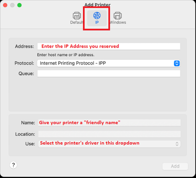

The printer requires a 2.4Ghz broadcast that supports WPA2 / AES encryption.  I would recommend assigning a static IP to the printer on your network.  This is done on your router.  What this does.  It creates a persistent (static) destination for the printer on your network.  (one that doesn't change)
Once done, remove the printer from the Printer and Scanner Applet in MAC OS.  Select the printer and use the (-) minus option to delete.
Restart your MAC.  Now return to the Printer and Scanner Applet.  At the top of the menu, select the IP Option for Add Printer.
Moving forward your computer or any device that joins your network can find and use the printer at its destination IP Address.
