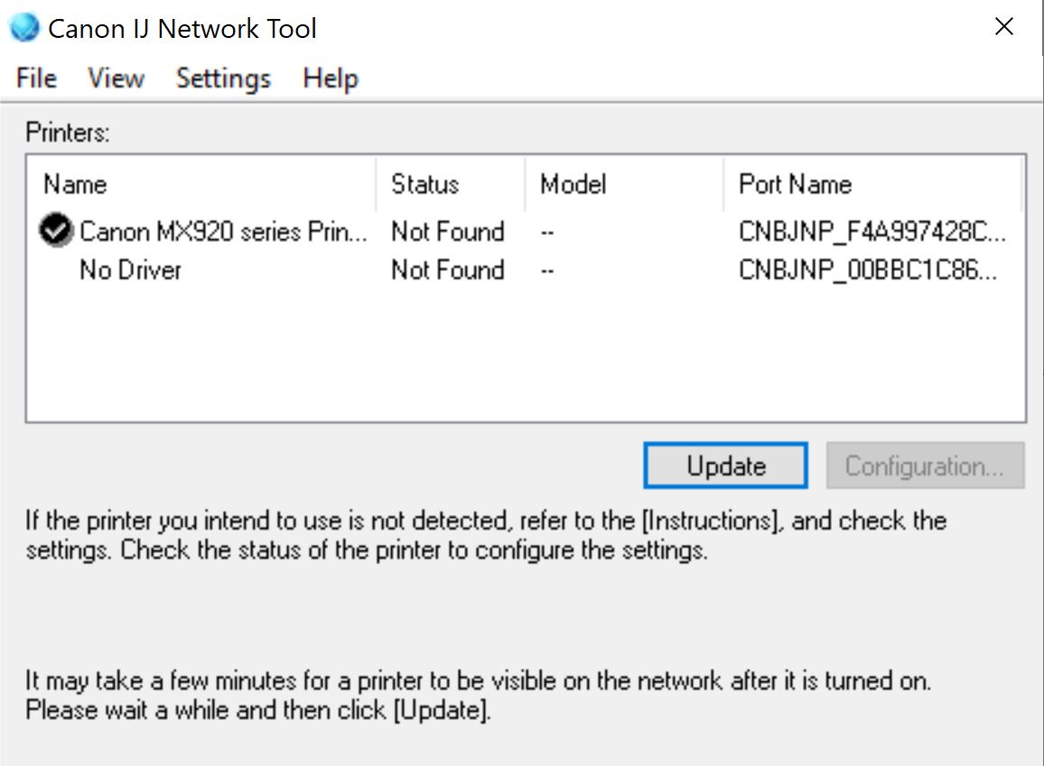

I ensured the printer is on the network. Re-did, several times. Router (Netgear R6200) shows it connected, it worked belfore on this Router
Printed out Network Config Page Which shows "Active" and on the same IP address as the router.
Ran the IJ Netowrk tool .......says "nnot found.
Multiple re-boots etc no help.
Suggestions???
Solved! Go to Solution.
05-20-2020 02:56 PM
FIXED:
The issue was with my ROUTER which was not recording the connected devices correctly.
I used WPS to put on network, and the IP address had already been assigned to another device.
I rebooted router.
I used MANUAL IP assignmennt at printer after WPS
Re installed the SW and everything worked.
