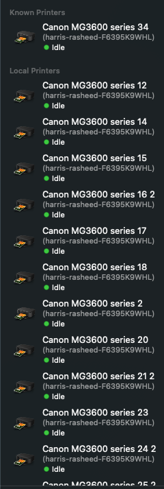

Anyone ever seen one printer generate so many detected printers?
I'm connected by wire and this list of growing "duplicates" keeps getting larger.

Removing was tedious because it's one by one and there are over 50 generated instances. In any case, I've done this a few times including printer restarts (power cable removed included).
Note that I'm not using WiFi for this printer and using a hard line (direct USB connection). I don't think the IP conflicts and Network equipment suggestions are relevant as a result?

The code I was referring to is the name and digit string under the printer name in the screenshot you posted.
As yes, that code is just my device name (static).
