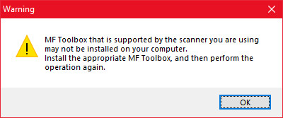

I have a MF4570dn, and recently upgraded from Windows 8.1 to Windows 10.
I can no longer scan using the MF Toolbox utility.   I had MF Toolbox 4.9 installed before the upgrade, and it worked just fine.  After the upgrade, I get "Cannot communicate with the scanner" error dialog:

If the MF Toolbox's buttons aren't responding (per your gif), even without an error message, then something on the computer is stopping the program from responding.  You can check for any conflicting software, and if you're on WIndows, you can check the TWAIN_32 folder (close all imaging/scanning programs, move everything from the folder except WIATWAIN.ds, then try the MF Toolbox again).  If the TWAIN_32 check works, then the problem is that another scanning, imaging, or video recording program is conflicting (I've also seen interactive whiteboard software cause this).
Hi Darius
I have only two items in my twain_32 folder: "wiatwain.ds" and a folder called "MF4100". But if I remove the "MF4100" folder, the MF Toolbox states that there is no compatible scanner installed on the system.
I have also checked that I have no other programs running. I have also no whiteboard or similar program installed. Do you have any other suggestions?
Hi Haeri.
If moving that folder didn't correct the problem, then something else is affecting the computer's ability to communicate with the scanner, and to operate that software.  You'll need to contact your computer's manufacturer for further troubleshooting.

Whenever I tried to run MF toolbox 4.9 , it always said no scanner installed, even when it was online and ok in the windows printers and devices.  Finally I tried "run as administrator" for MF toolbox, and it works ! Finally, just set it up permanently in the executable file's properties and no more troubles.
