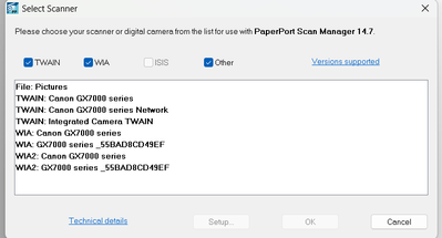

I downloaded and installed a trial of Paperport 14 on my system (again I'm on Windows 11, but I expect Windows 10 to be the same). The "Select Scanner" dialog shows all my TWAIN and WIA drivers:
I'll be honest - I'm not sure why there are 2 WIA drivers for each local (USB) and network install, but you can see there are indeed both WIA and TWAIN drivers. I did some quick tests and I could not figure out how to get the WIA driver to do duplex on the ADF. However using the TWAIN driver I could get duplex by either going "settings > Scan > Source: Duplex ADF", or by choosing the option "Display scanner dialog box" to bring up ScanGear and choose the settings from there:
In short, I suspect that the issues are likely a problem with your particular setup then the device and/or software. Hope you figured out another solution (it's been a year) but maybe this helps someone else!
