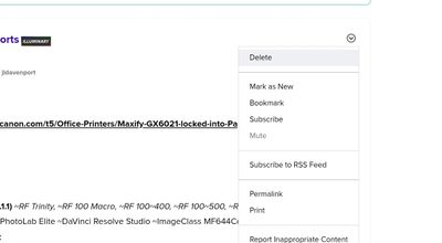

You can use the drop down menu to the right to delete posts or replies.
