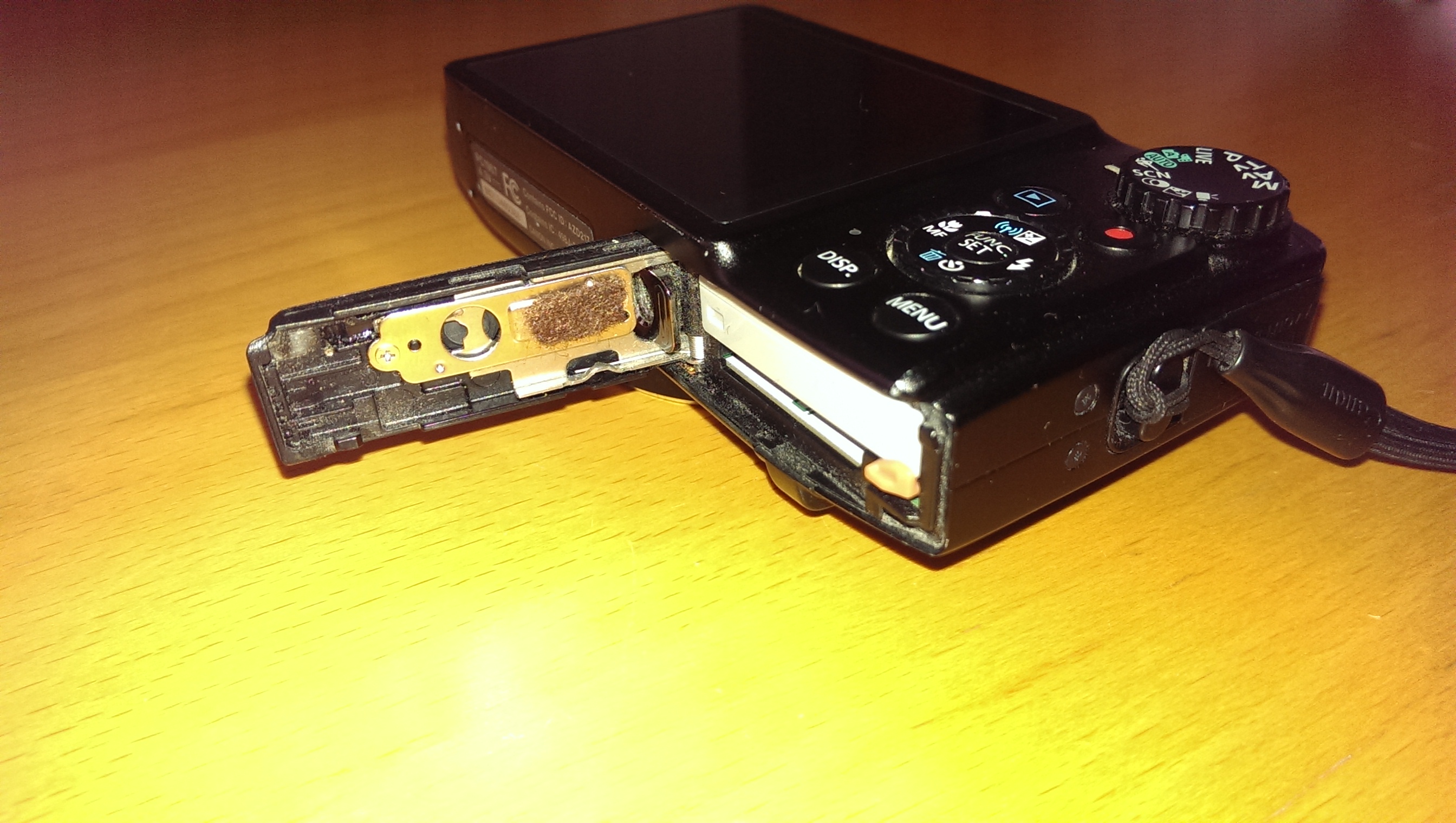

07-17-2015 01:21 PM - edited 08-20-2015 11:35 PM
Wow!!! I've had this camera for 2 years with the battery issue. At the end, I was systematically removing the battery for about 15 seconds every time I would shoot a video since the low battery indicator would show and, if I turned off the camera, it would indicate that I had to change the battery when I was turning it back on. This trick seems to work. I installed a little piece of floor protector (what you put under a chair or table to protect a hard-wood floor). I had one which was black and very thin which was perfect.
At first I put a piece which was too long and would make it difficult to close the cover (I did not close it as I did not want to break it). After I cut that piece in two, the door can easily be closed (still need a little more pressure than without the workaround) and I was able to shoot about 10 videos ranging from 10 to 30 seconds ... and I have not yet seen the low battery indicator!
I'm attaching a picture of the result as well just to show where I put the piece and its size!
Thank you, thank you, thank you! I was getting really tired of this issue and was about stop shopping for another model. I'm very happy with the photo and video quality. So, I'm even more grateful that this issue is resolved!
