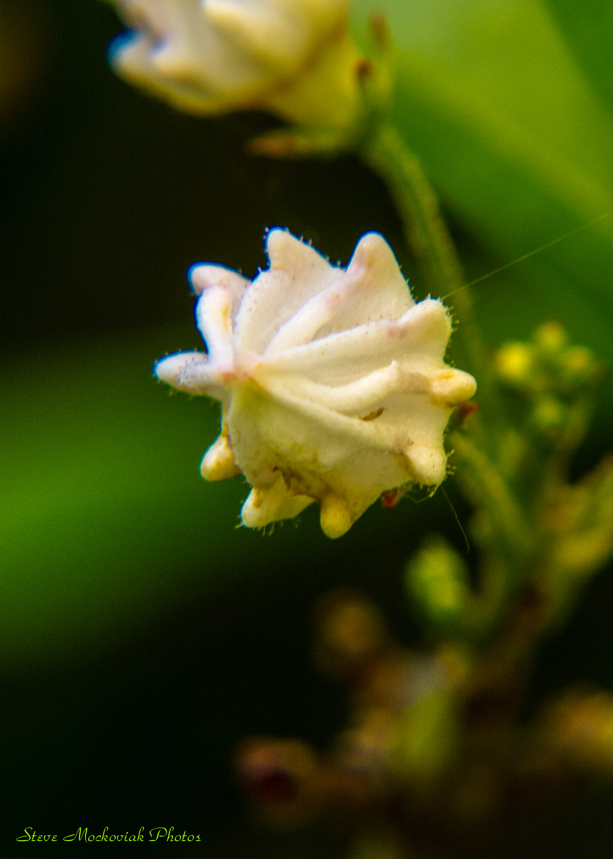

I have the PowerShot G12 camera and I use the 1.4x teleconverter on the barrel adpater to increase the focal length to 196mm (equivelent), and keep the subject as far from the background as possible. I shoot in manual mode with a wide open aperture, but since the sensor is small, the bokeh (blurred background) does not get as creamy smooth as with a larger sensor camera. Attached is a sample of one of the G12 shots I've taken:
Steve M.

P.S.  Thanks for posting the flower picture.  I see what you mean about the background, but I'll be happy if I can achieve that level of blurryness.
