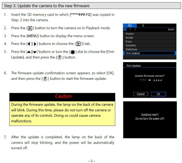

Have you downloaded the firmware update file and read the directions to install on the camera? If so, what is not working for you? Follow these instructions exactly. Do not use the power button to turn on the camera, use the playback button (triangle) to turn the camera on. The firmware update menu will appear if you do it this way.

I'm having the same problem. Pulled out my camera after not using it for quite a while. Cannot connect with my phone etc.. Says that I need a Firmware update. I have no idea what version that I have. I have done what is suggested above.
I downloaded: PowerShot G7 X Mark III Firmware Update, Version 1.3.2 [Windows]
Put the SD card in my camera.
Turned it on using the playback button that is directed above. Did this using several different modes as suggest by someone above.
My menu is different. Only 2 tabs and not 3 like the one above.
Any other help would be appreciated. Maybe I need to go back and get some other updates first?
