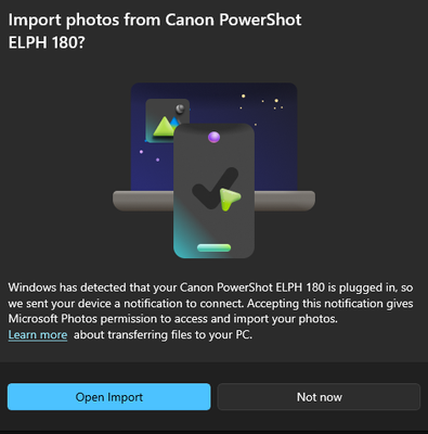

I have an ELPH 180 and use it on my Win11 Desktop.  Recently, it doesn't connect like normal.  It does CONNECT to some sort of Win-MS program that I do not like at all.
It works like always on my wife's desktop, using Win7, I think.  In all these years I have NEVER had any problem with it working correctly.
I'm thinking something might be wrong with my computer, but two virus programs finds nothing,
Even thinking of "re-installing" Win11, but not sure if I should do that.  Just thinking some ":glitch" might get corrected.
I did read  your reply, above, but am not interested because of MY USAGE.  I sell products on-line, take a picture, edit it then and post it.  This current program is totally worthless to me.
Any suggestions?  I think this camera is plug and play, but certainly not on my box right now :).
