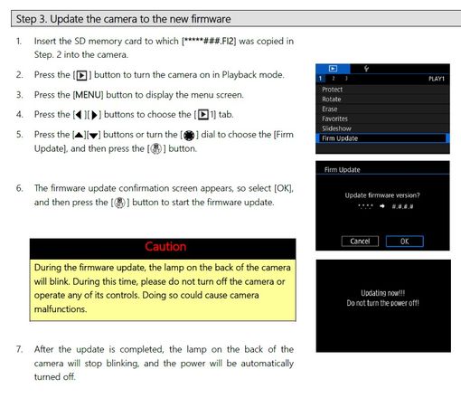

Here is a page from the firmware update instructions.

What mode is the top dial in before pressing the playback button and menu buttons?
Do you have an SD card in the camera with the firmware file on it?

Hi, I have tried placing the dial under several program modes as well as Manual. There was no difference at all. Regarding an SD card, yes I do have one in there. I have tried it with two different firmware files, both the newest one as well as the oldest that I could download from the Canon site. FWIW, I have two pictures in one of the posts above showing two different versions of the playback menu where the the firmware should be. What's interesting is that I can now only get to the one with two tabs rather than the 6 displayed in the other image. Note sure how I originally got to the one with the 6 as I can't get back to it. Thanks for trying to help as I am at a real loss. I have updated the firmware of many cameras ant the like in the past and I have never had such difficulty. I must be missing something and I just can't figure out what.

Shadowsports and 5Div, thanks for your help in trying to solve my issue. I finally solved my problem, by doing 2 things differently. Not sure which did it, but in the event others run into this problem the firmware option did not turn up for me until I
A. Used a Different Card and B. Used a different reader to install firmware on the card. My inclination is think that it was the using a different card.
10-19-2023 01:20 AM
Cheers and congrats. 👍 Bob will be happy to hear this also. Hope you are using a full size memory card and not a micro SD with adapter.

I have this issue. I have tried everything I can find out. The "firmware install" never appears on my Canon G7X Mark II.
I have tried the following:
Used three different SD cards. Two SanDisk and One Kingston
Used an external SD card reader, used a card reader that is built into a laptop and a second card reader on a PC (instead of a Mac)
Set the camera to "P" mode and to "M" mode
The firmware install toggle never appears.

OMG, it just worked! I was looking at the wrong menu? I thought is was in the tools menu, but it is in the playback (blue) menu. I hope that anyone reading through this will get a heads up.
