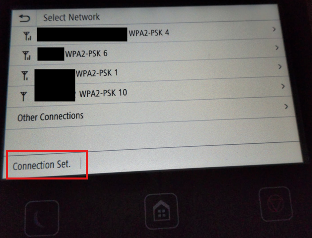

After a few hours of messing with my nephew's birthday present, a Canon MF665CDW, I came to make this easier to find.
https://oip.manual.canon/USRMA-9960-zz-SSM-660-enUS/contents/devu-set_menu_list-pref-nw-wlesslan.htm...
[Preferences]
[Wi-Fi Settings]
[Connection Set.]

05-21-2026 07:12 PM
Oh - I posted the solution
I disabled Power Save Mode
Now the printer is always connected to the WLAN.
