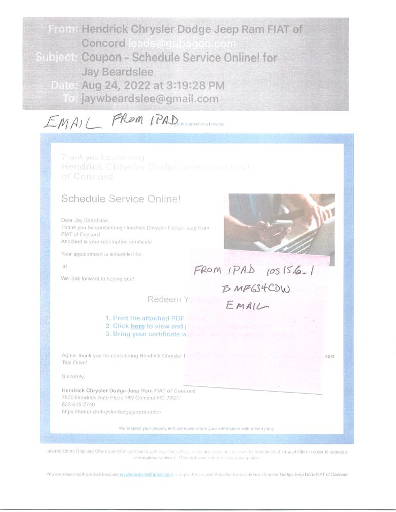

‎09-03-2022 08:07 PM
Hopefully the attached scans will give you an idea of my problem. Thanks!a of my problem.
