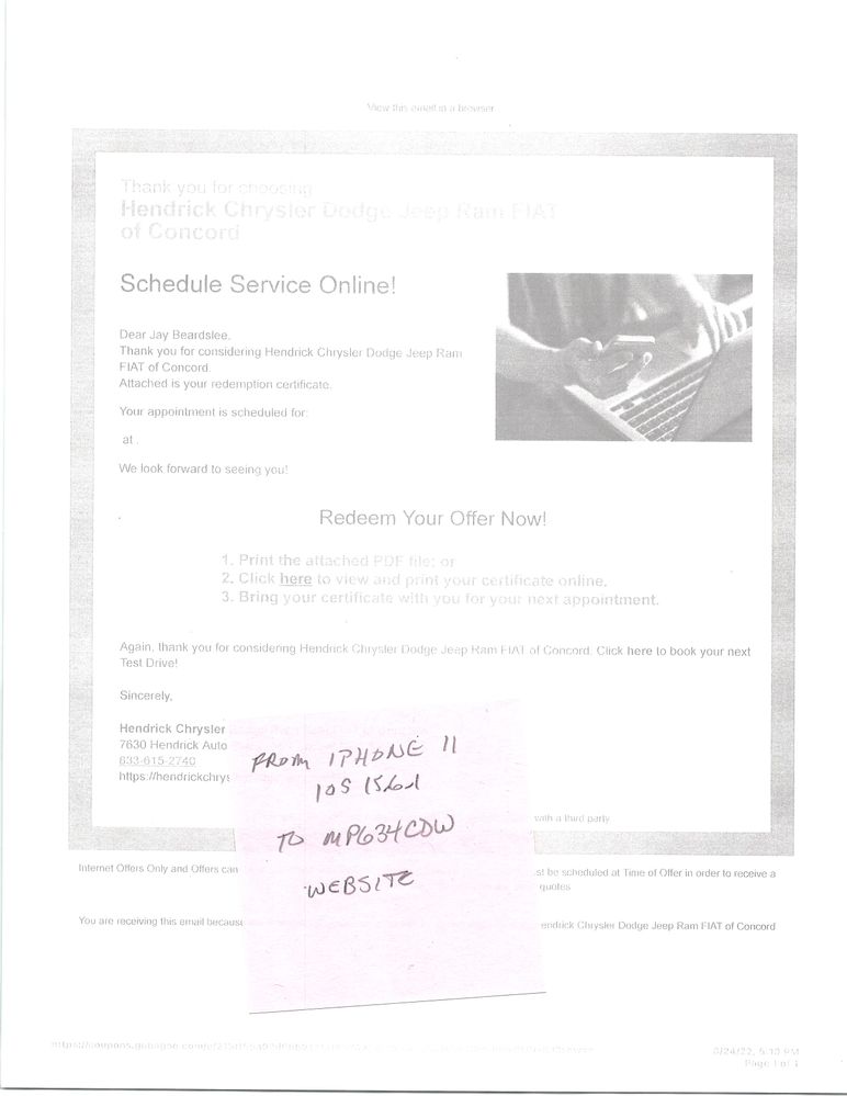

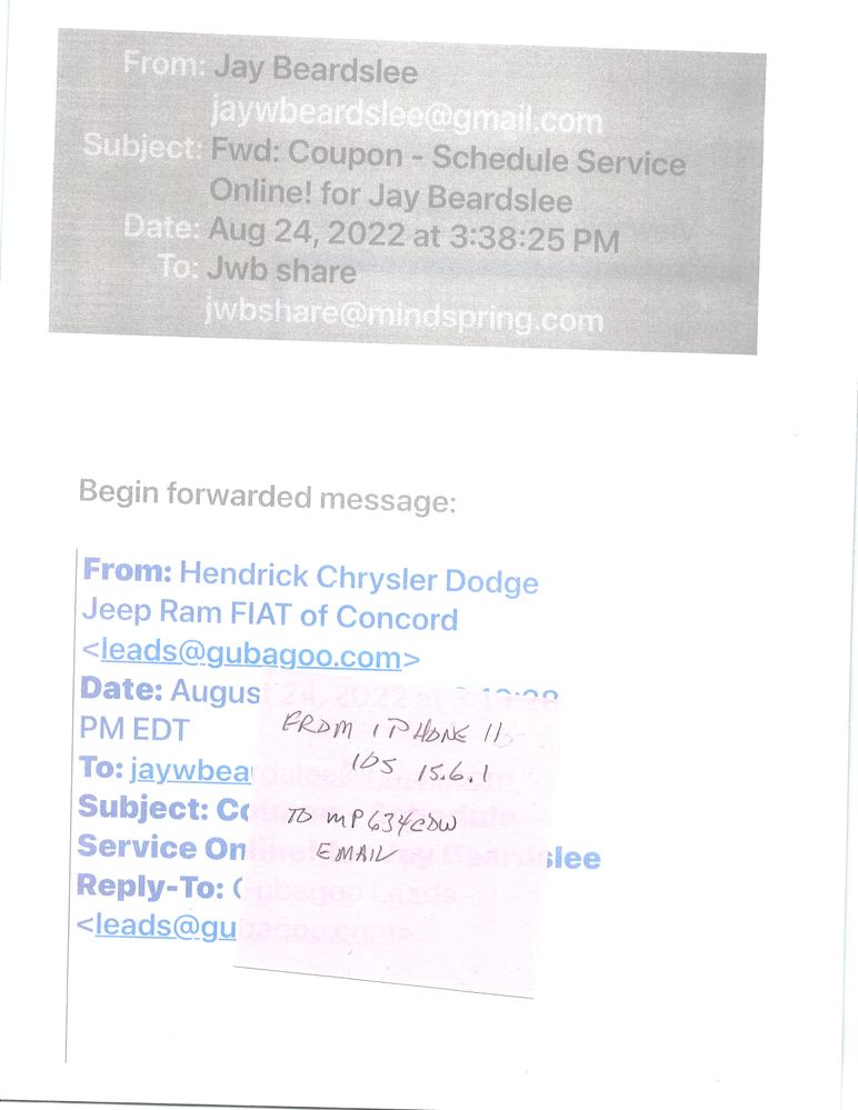

Hopefully the attached scans will give you an idea of my problem. Thanks!a of my problem.
