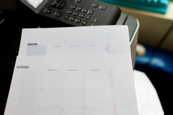

11-30-2019 12:00 PM
Hello
Yeah, I check to make sure the toners were in the right spot, I did shake them, and I'm using regular 20lb paper I got from Target I will insert pictures. It wouldn't bother me so much if the grays and pink didn't come out like purple. The top one is from an HP injet printer and the one under that is the canon.
11-30-2019 12:02 PM
example two the one on top with the hole punch is the hp inkjet
11-30-2019 11:48 PM - edited 11-30-2019 11:52 PM
The purple your describe is looking more magenta to me which indicates double color managemet. This means both the printer driver and the application or your OS is managing the color profile the printer is using. This causes the colors to be off.
I have a feeling this is your problem. The best way to fix is to disable all color managemet in the printer driver, and allow all control to be dictated by the application you are printing from. Hoping this will help.

12-02-2019 09:29 PM
Yes it did, one more question do I need to uncheck {Application Color Matching Priority?}
12-02-2019 09:29 PM
and thank you!
12-05-2019 12:48 AM
@JCassiW wrote:Yes it did, one more question do I need to uncheck {Application Color Matching Priority?}
Greetings,
Yes, if you want to disable color management in the printer driver.
