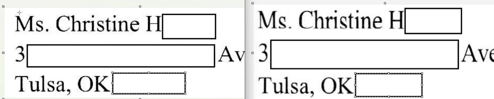

The issue at hand is quite bizarre. It is not easy to replicate across documents, though I have seen it multiple times. I have one document that I was able to save where I can recreate the issue at will. Sometimes the issue appears only to a small extent, and other times a larger, but it happens 100% of the time.
With this document, when I feed it through the ADF in correct orientation (face up, top towards scanner) distorts a line of the document. What is strange is that this distortion is about 25% down the document. There is text both above and below which doesn't distort. Below is an example of the normal text (left) and distorted text (right):
You can see, especially in the first 2 lines strand distortion as if the lines are stretched out in some ways and squished in others. This happens every time.
