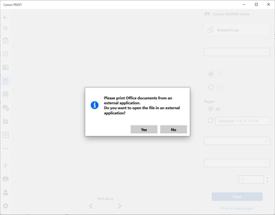

I downloaded the Canon PRINT app to the laptop but haven't been able to get anything printed. I get this message:
