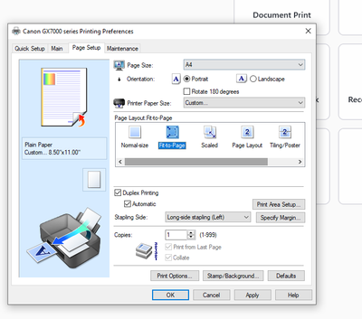

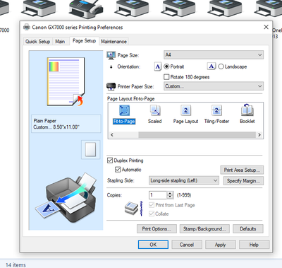

theprinterdude
There is no borderless option here.
theprinterdude
Is there anyway atleast make the border small?
