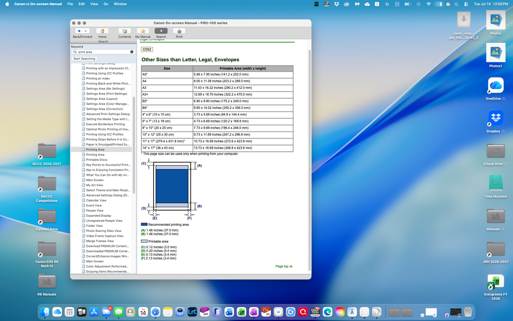

My printer is the PRO-100 and it uses Canon Print Studio Pro, which is a plugin only and the predecessor to PP&L.
Here screenshots from the printer manual, showing the printable area for various paper sizes support by the PRO-100. You should be able to get a similar manual for your printer.
Screen Shot 2026-07-14 at 12.50.21 PM.pngScreen Shot 2026-07-14 at 12.50.21 PM.pngScreen Shot 2026-07-14 at 12.51.18 PM.pngScreen Shot 2026-07-14 at 12.51.18 PM.png
Borderless printing slightly increases the image size to allow printing to exceed the margin area. The amount of extension can be adjusted. You should size your image to go to the maximum printable area in at least one direction (if your aspect ratio is different than the paper aspect ratio).
