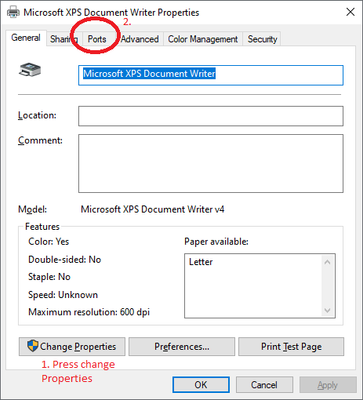

Open Control Panel again and select Device and Printers
Choose one of the other devices and right-click (select Printer Properties)
Properties dialog opens
1. Press Change Properties button
2. press Ports tab

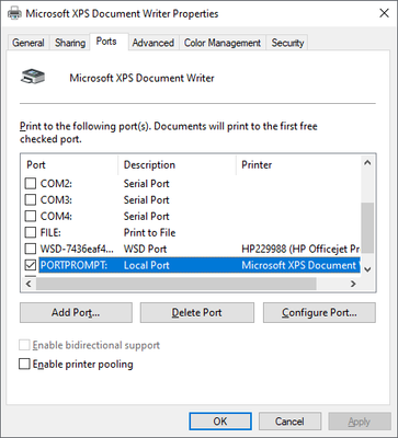

When the Ports tab is selected the dialog will refresh
Note the box which is checked for the device you opened (important)
Now check the list for any Canon related printer entries (note, you may have to scroll up or down)
If none are present, you are done and can close (cancel) the dialog
If a Canon device does exist, put a check mark in its box and select Delete Port button
Do this for each Canon entry
When done, re-check the box that device had assigned (first opened) and press OK (important)
If you don't select it, you cannot close the dialog
Now you are ready to reinstall the printer and its drivers
