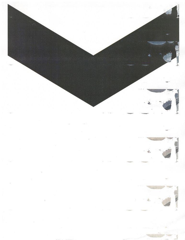

Having an issue with our Canon MF743CDW. Picture is attached from when the fixing assembly was cleaned as it accentuates the problem. This happens on any page that we print. It always catches part of the ink and deposits it across the page as it prints. I've tried all of the maintenance items available in the printer menu. Any suggestions?

The image that you posted looks like there is a problem with the fixing unit or the drum on one of the toner cartridges. You can try inspecting the toner cartridges for any signs of damage or try replacing the cartridges to see if the print improves. If replacing the toner does not resolve the issue, it looks like the printer needs service. You can log into your MyCanon account or you can contact support over the phone at 1-800-652-2666 to check your available service options.
