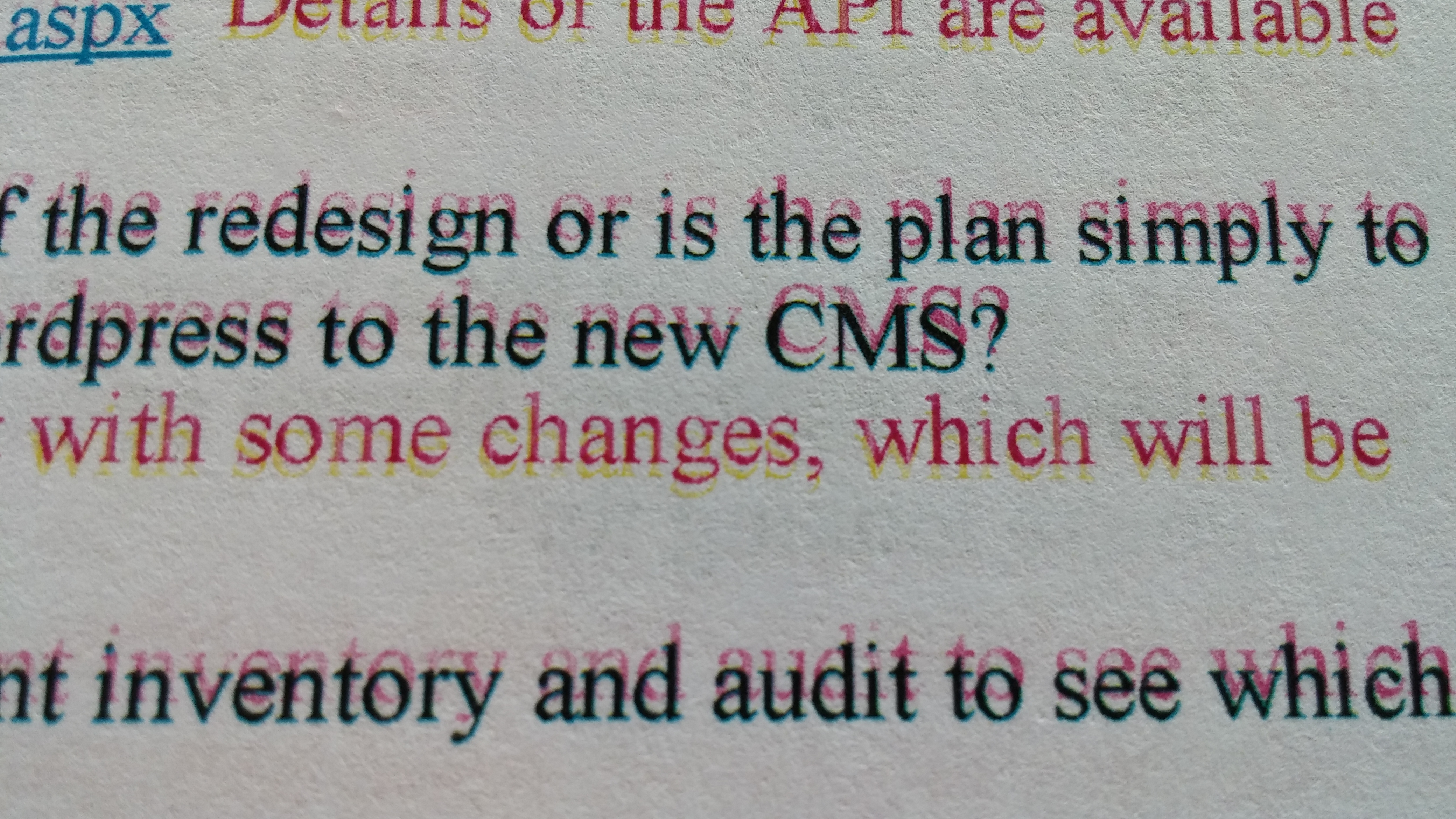

When I print text documents with color elements, they print with red text hovering over the black text, producing a ghosting-like effect, making all text (which should just be black anyway) very difficult to read.
As I was adding the photo, I noticed that it's also printing yellow text under the red, where the text should just be red.
I think this is an alignment issue, but I can't figure out how to fix this. Any ideas?

I will be able to assist you with this issue. It is recommended that you perform an autogradation adjustment. Please follow the steps in the link below to perform this adjustment:
imageCLASS MF8580Cdw - Correcting the Gradation
I hope this information is helpful to you. Should you need further assistance, please contact us at 1-800-OK-CANON (1-800-652-2666).

If the steps provided above do not correct the problem for your MF8580, you may also try Correcting Print Mismatch.
