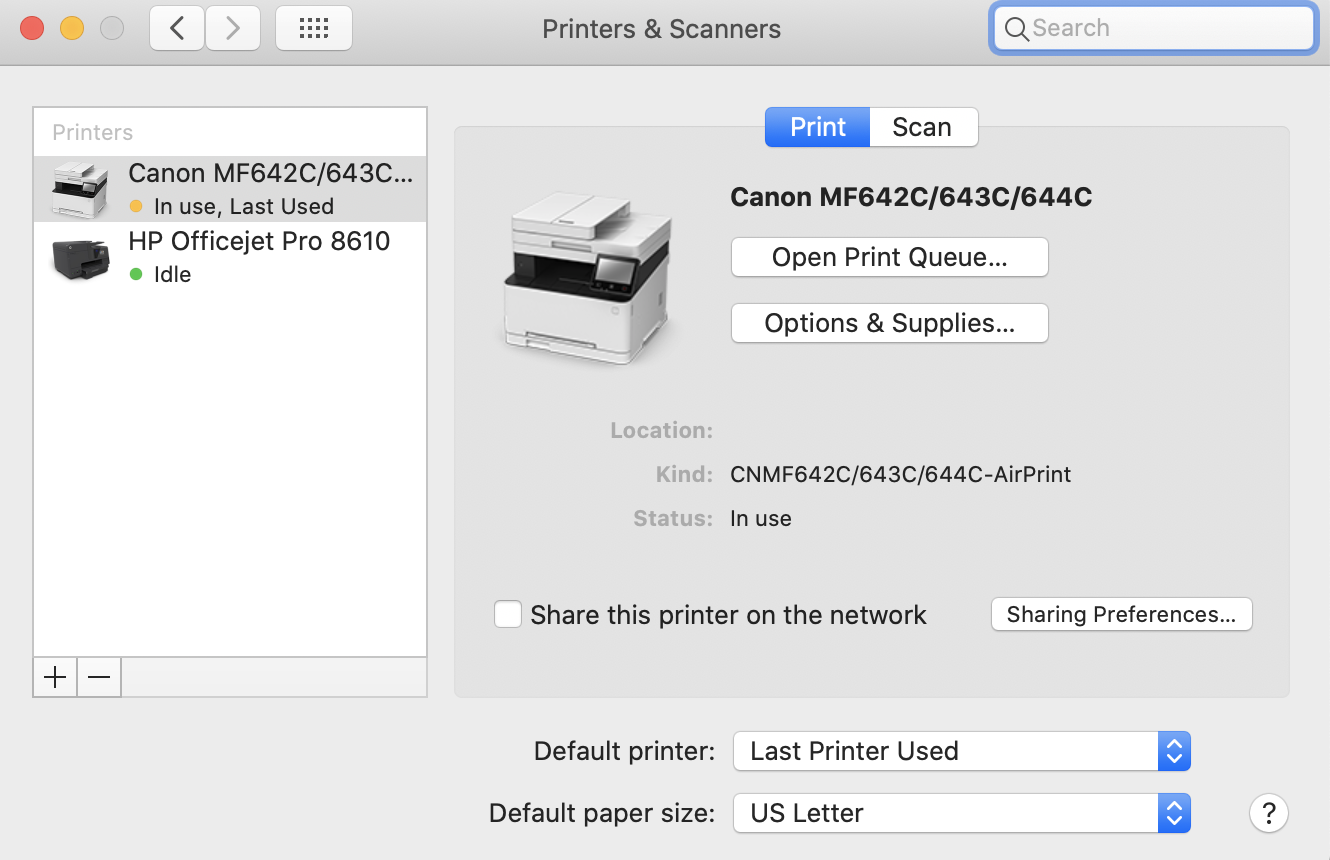

I am having issues with my Canon laser printer I just purchased and I've tried calling customer service but the hold was way too long. The issue I am having is that the printer will stop printing/being connected to the server after being idle or away for a bit. I will have to go into my Macbook settings and delete the printer, disconnect the wifi on the printer, and then reconnect wifi, and then add the printer to my laptop again. It is such a hassle. I check the wireless LAN settings on the printer and sometimes it will switch on and off and say disconnected. I even turned off power save mode.

Screenshot from my Macbook Printer & Scanners setting:

I understand that your Color imageCLASS MF624Cdw is not staying connected to your wireless network. I see from your screen shot that you are using the "AirPrint" driver.  If you have not already done so, I suggested you download and install the driver for your MF624Cdw from our web site (click HERE) then follow the steps below to add the network printer using the MF624Cdw driver.
