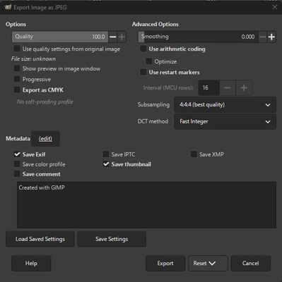

Many Selphy users have this problem, and I have eventually found a solution.
The Selphy printers were designed to accept Exif format files with jpg images direct from digital cameras, however technological progress has overtaken them and nowadays a lot of my jpg photos come from my smartphone and friend's smartphones, or files sent to me via email or whatsapp. These jpg photos work fine on everything else apart from my Canon Selphy, where it just indicates a question mark on a black background.
My model is a Selphy CP720 which prints perfectly but has no Canon PC software for Windows 11.
There are several fixes online, which unfortunately didn't work for me, however there is a free open source photo editing programme which produces Selphy-compatible pictures consistently.
Download and install GIMP (GNU Image Manipulation Programme), which is a comprehensive photo-editing application and open a jpg in it.
The only processing I have to do regularly is to crop each picture to 3:2 aspect ratio so it prints correctly on my 6" x 4" photo paper. Once that is done, select "File" then "Export As", then "Choose Location" (I choose my SD card drive), then select "Export".
A large dialogue box will open, and you need to check the boxes for "Save Exif" and "Save Thumbnail" then you can also save all these settings for future use, then select "Export" and you will have a file on the SD card or whatever media you have which will display and print on your Selphy.
GIMP export dialogue box
