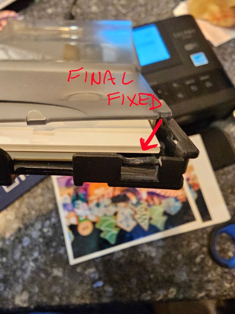

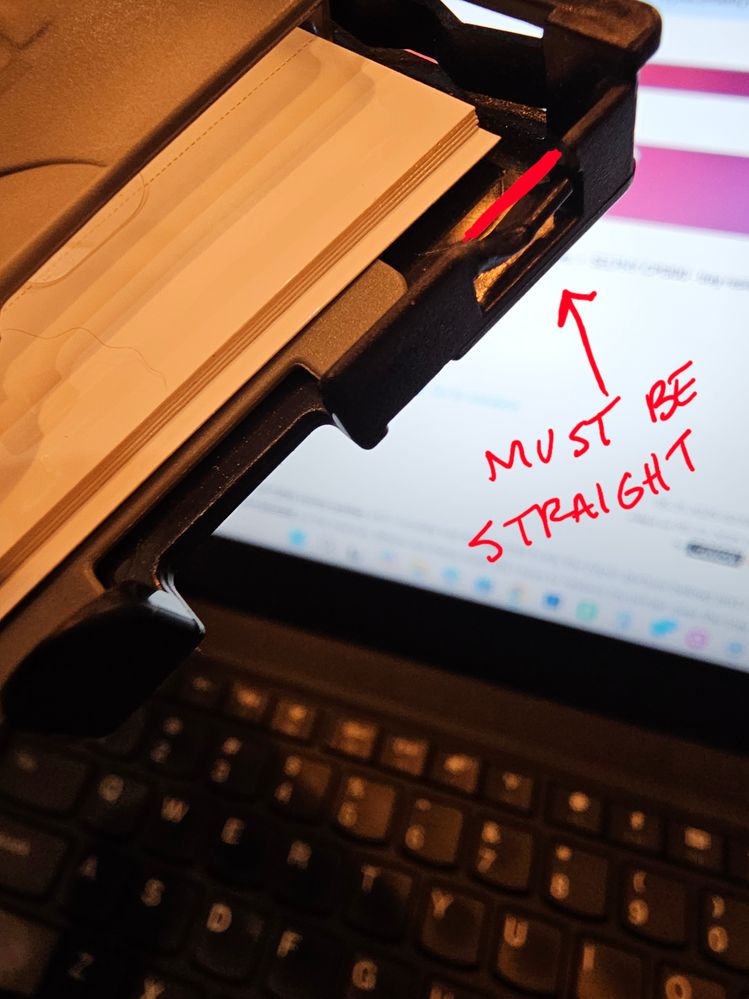

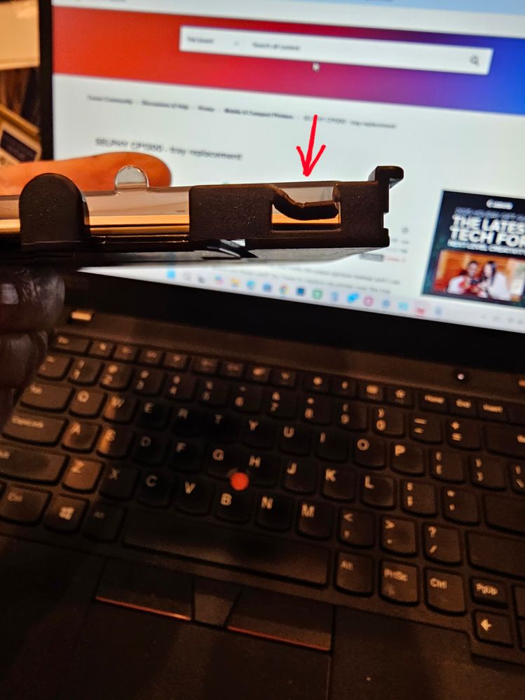

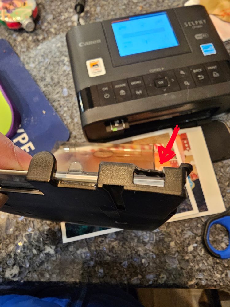

I just fixed this error on my CP1300. It was driving me crazy. Pull the tray out and check the plastic piece. Mine was bent/almost broken. I gently reshaped it with very small jewelers pliers that I had on had. It fixed the issue. I toiled with this multiple hours. I tried many packs of the proper paper and cassette. The app is terrible. To change from L to P (Japanese Postcard) you need to login on a computer or use the selphy app, which then states that you need the Canon App which is over simplified. My error was 100% the physical tray piece being bent. I'll try attaching photos.CP1300First.jpg
