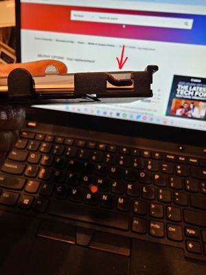

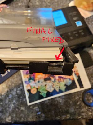

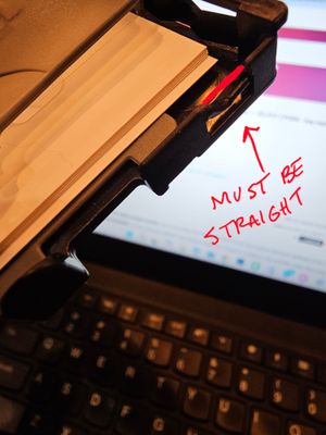

12-19-2025 12:19 PM
I just posted my fix for this issue. My tray was partially bent/broken. I was able to gently straighten it. It finally works again!
