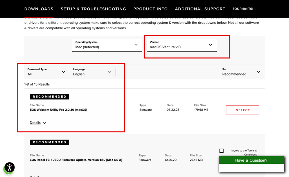

Have you tried using EOS Webcam Utility Pro 2.0.30 (macOS)? The website claims it is compatible with macOS Ventura. However, I'm a bit hesitant to update my Mac in case it doesn't work. Has anyone else tried it yet? I'd appreciate some feedback from others who have tested it.Screenshot 26-07-2023 20-50-10.png
Do you have a Mac with an Intel chip or an M1?
If you have an M1 chip, my experience is that it doesn't work. The software runs, but the signal from the camera doesn't appear. If you have an Intel chip, it may work.
