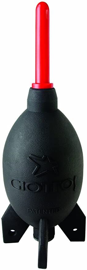

Yes, you image sensor is dirty.  It could simply be dust, which can be easily blown away with a special bulb blower.  Beware of cheap knock-off brands because they bulb can contain dirt and blow it inside of your camera.9FDE623F-7F7D-4764-8B04-A02D76E8C4FA.jpeg
